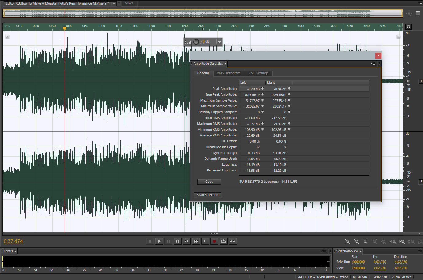

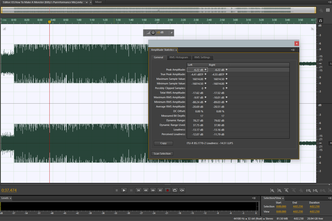

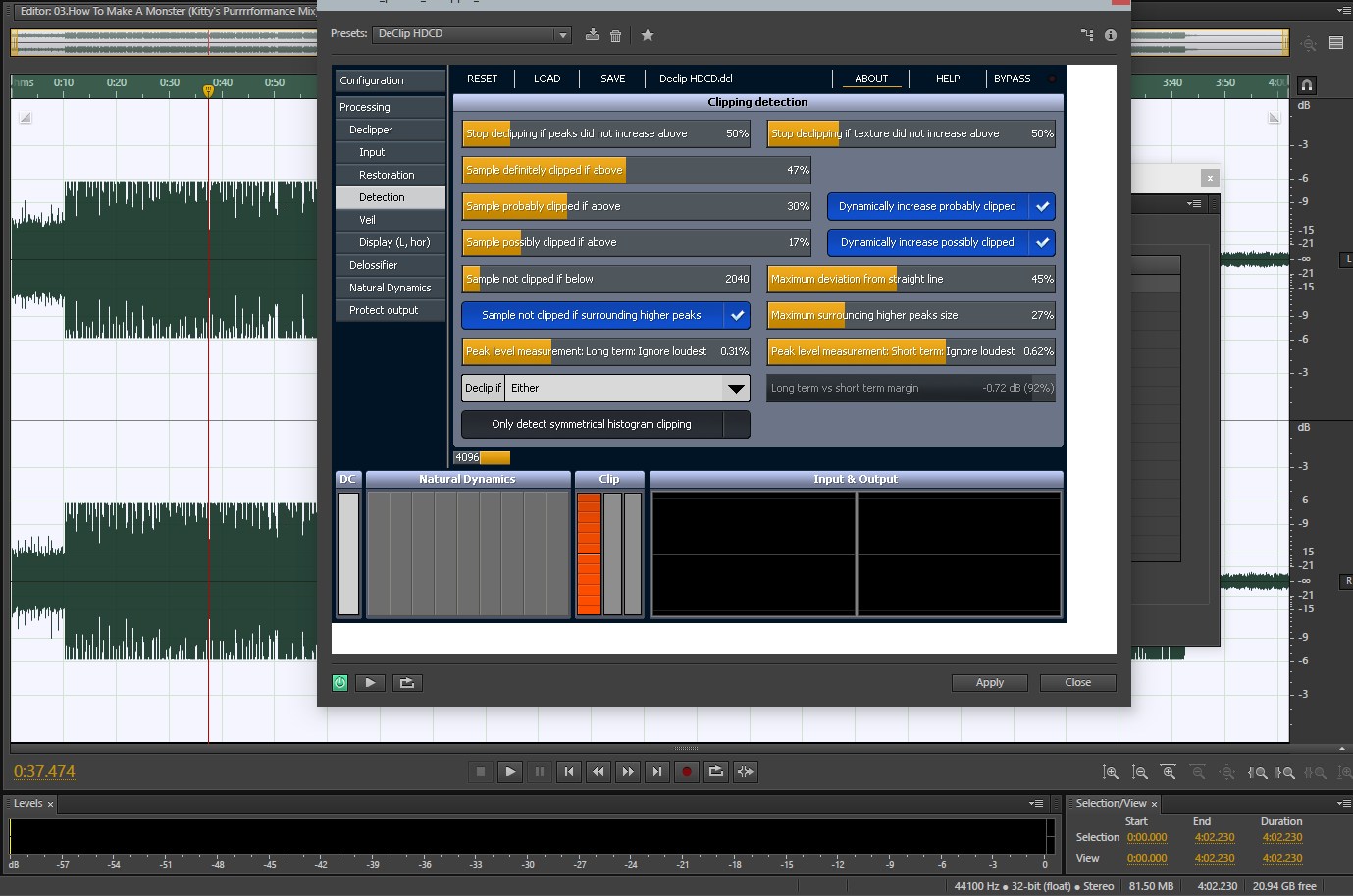

Using just the DeClipper part of StereoTool to rebuild peaks after decoding an HDCD with dBpoweramp results in very satisfying sound. Many of the HDCDs out there did not have the peak extension setting chosen, so the result of decoding those CDs with the HDCD option in dBpoweramp results in a 24-bit file with a measured 17-bit bit-depth. For example, Rob Zombie's 1999 album, American Music Made to Strip By, is HDCD encoded. Decoding it results in a 24-bit file that is -6db peak, and so we need to decrease the declipping settings by 50% as shown in the screenshot. The result is nothing but impressive...
File comment: How to Make A Monster - Track 3 on Rob Zombie's 1999 american Music Made to Strip By

File comment: StereoTool's DeClipper Settings - note: -6dB is 1/2 the volume, so simply take 50% away from the initial DeClipper values.

File comment: After DeClipper runs. Note: this does not even have natural dynamics on. The results are stunning...
