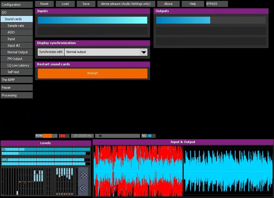

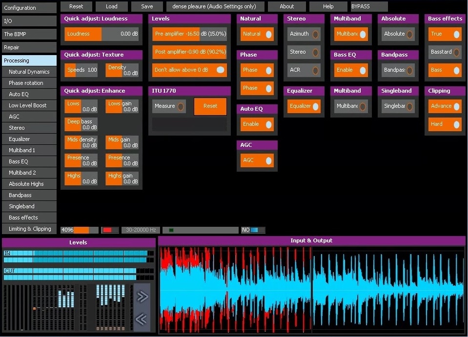

I never ran into any problems with this preset. I am using this preset now... (see picture)
That happened to me when I choose "Load all settings" button when testing the preset on a new machine. I have to reselect the input / output soundcards again.
Make sure to Load all Audio settings and load your I/O settings from your previous working preset

Looking at your pics, doesn't the pre-section (input) look hugely clipped? Output looks OK. Wouldn't this cause unwanted distortion?
