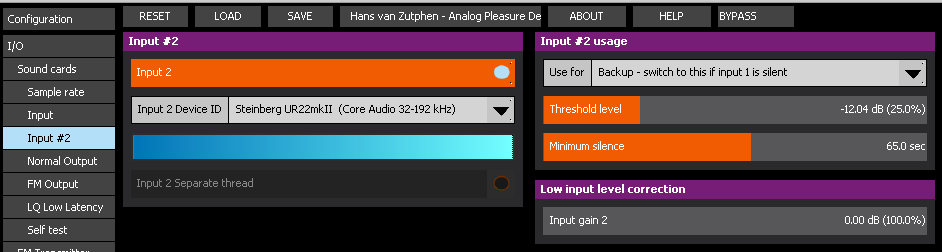

You can use input #2 in ST to fade to that input in case the first one falls silent. It can not play files though, but you could have something running on that second input that plays "something" all the time.

Yes i know. But two things. i need to have non-stop something on that input. And second, It does not turn off completely input1 when it is switched to input2
