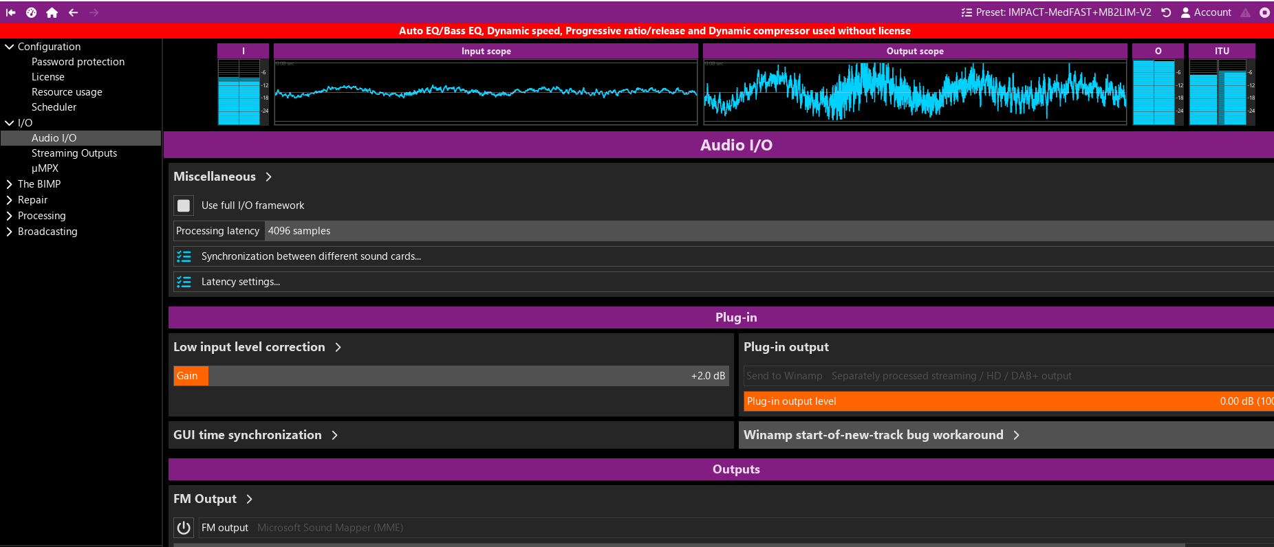

I'm using Stereo Tool for home use (no streaming), and I noticed, unlike with previous versions that I've used, when I adjust the post amplifier slider (I/O section), the volume level changes, but the Output meter does not reflect any adjustments made with the slider. The output meter remains solid at around 0dB. Could that be a possible bug, or is that by design? Thank you...

Ok. I checked through my settings to see if I missed anything. However, I forgot to mention before, that the part in question is the Plugin Output, if that makes any difference. So, I think I confused that with the post amp slider from previous versions of ST, when the layout was different. I looked through the Advanced Clipper/Final Limiter section, anything having to do with the overall, final output level.
Nothing in the streaming section is turned on, or turned on in the HD output section, either.
I've attached screenshots to illustrate some of what I mean. The first two to three screencaps, show the Plugin output level slider showing the volume level changes, but the output meter remains at the same level. I can hear the levels change as I move the slider, but the output meter doesn't follow those changes.

I've added a few more screenshots... In one of the shots, there is no audio passing through, thus no meter activity... I'm just checking over the settings in the Advanced Clipper/Final Limiter output.

The Post-Amp was removed from the Quick Adjust on the Home page. However on the Processing page, the Quick Adjust offers the ability to alter the pre and post amp sliders.
What you're showing is the level sent to the DAW, not the level processed internally.
