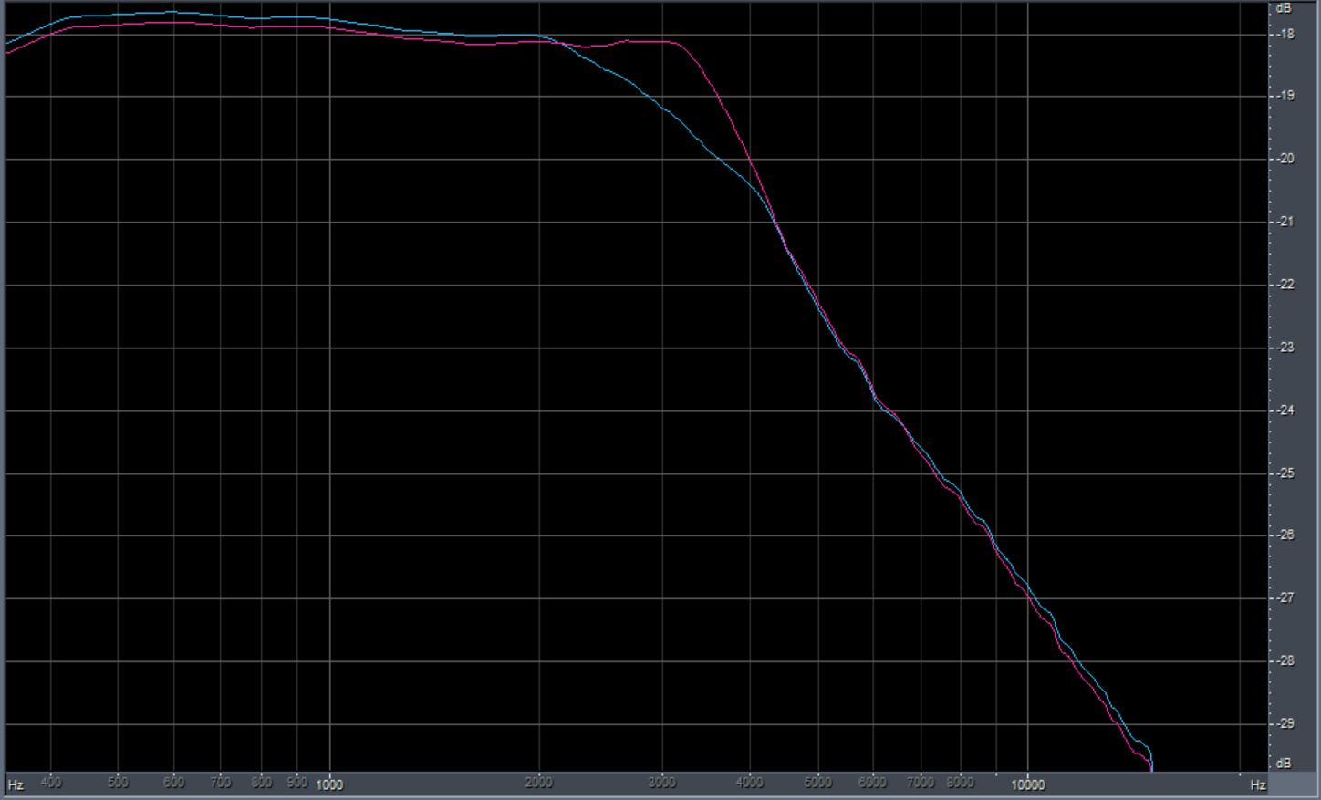

It's starting to look a lot better.
I have not yet listened to music but based on this graph, this should be way better than before. Cyan = without Leif's Gap, purple = with new Leif's Gap.

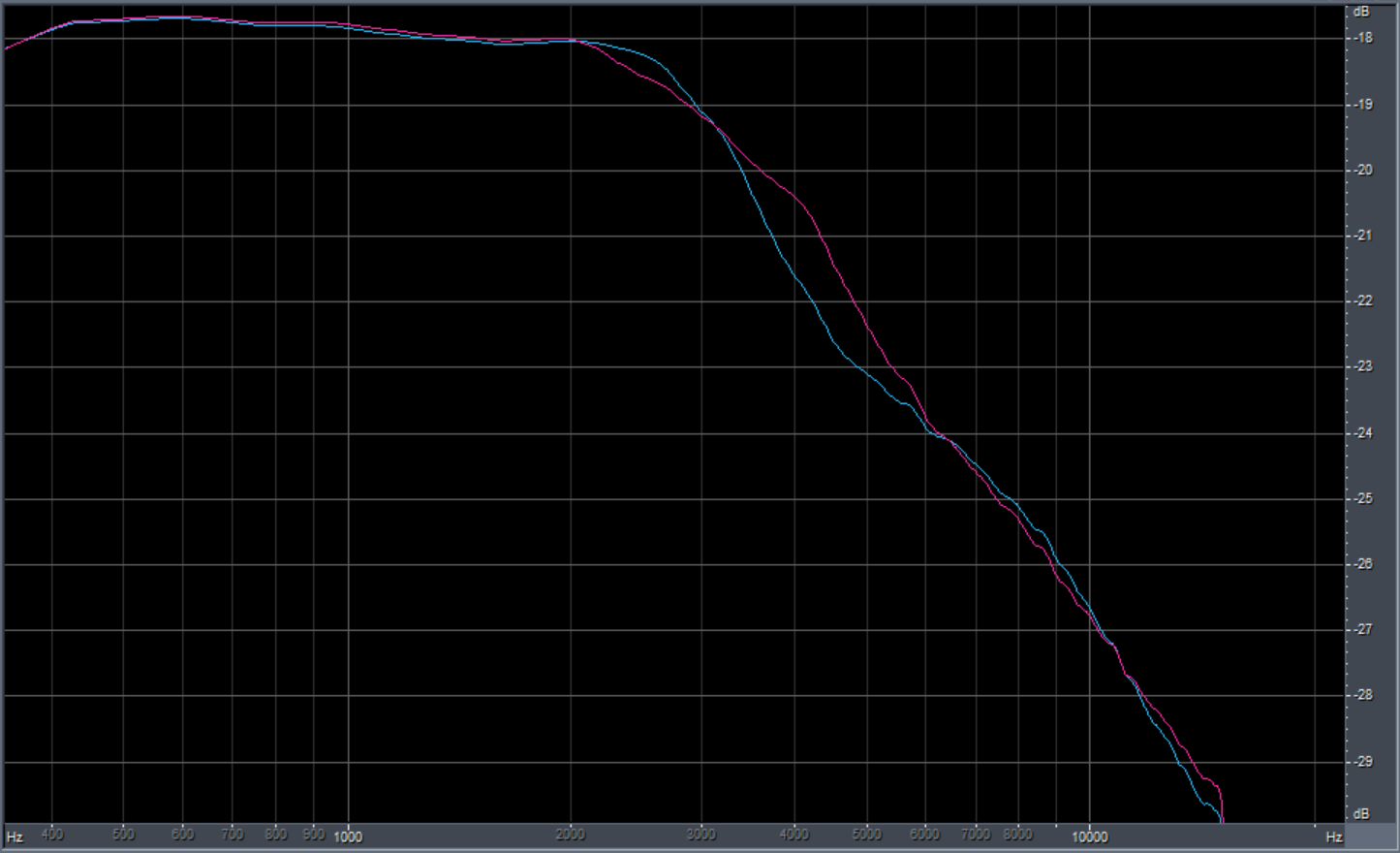

And, just for fun, this is what happens when you move the filter frequency by 1000 Hz. This can have a big impact on the sound so I'm going to make this configurable.

Yes, yes.. way better now. And with that configurable can be tuned even better. Also i now can again set Higs/Rest back to ~220%.
