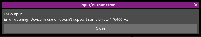

Since BETA016, below error message appears at startup. The actual FM output device is a USB2.0 audio device (Kernel Streaming).
EDIT: this reply should reside in the 10.71 BETA topic.

If you do back to older versions, does it work again? It could be a Windows/hardware/settings issue, hence the question.
Yes, when I revert to BETA015 or lower, all is fine again.
PostPosted: Thu Sep 25, 2025 7:44 am
Can you send me your .ini file? It's in C:\Users\username\stereo_tool.ini. You can remove your processing settings if you want, I'm only interested in the I/O and FM settings.
Edit: Never mind, this broke on our end, cause found.
Edit 2: Solved. Should be ok again in tonight's build.
