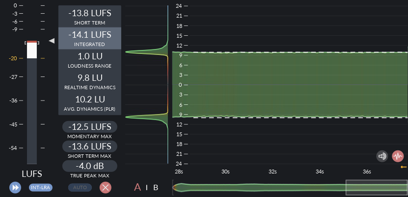

Here are the settings for my station. They're set to work with an input signal at around -16 dB LUFS or around and leaves a -14 dB LUFS signal. It's setup to stay close to YouTUBE-standards for loudness and AES standards for streaming. It's a little bit "hotter" than AES recommends, but the peak is set @ -4 dB.
Pretty satisfied with it and it sounds good. I don't really want to push stuff up to -9dB LUFS.
The station is here: ericade.radio
correction: I wrote "I created it to...". It needs to be stated that I used another preset (see comment below) and modified it... This has now been changed.

The Loudness range is closer to 1.5-2.0 in reality, but I just started YouLean to give you a fast reading...
