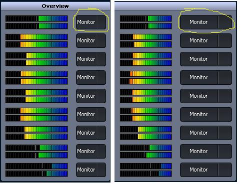

PostPosted: Sat Mar 23, 2013 9:41 pm
This is what i mean....
This button is looking bad.... like dead :)
i mean to make it little more space like this one in right , but may be not that big.
Just to make it more to look like button :)

Looks like Hans don`t understand me for the Monitor button , but nevermind.

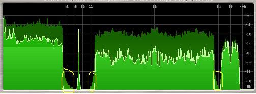

in older versions the bandpass filter was looking more STEEP..
But in latest versions it looks different ?!!? Any explanation about this one ?
i see that there is peaks to -80db ... where in old versions they was at max -90db down , and everything from the value of lowpass to pilot signal was more strong down. Now it seems to be softer .... Hans did you do something to the filter ?
I`m talking about these ones in the picture.... on older versions it was not like this.
