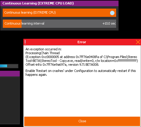

Posts: 1018
Beta 8 is the first one I've tried, but it seems the Dehummer breaks output for me. It appears to process everything correctly, according to the scope. However with the LQLL on for monitoring, I hear plenty of "skipping."
I haven't tried many other permutations yet, to narrow it down. But I noticed it stays "enabled" after changing a CPU/buffer setting.
I see no problems with it in BETA008. Could it be a CPU load issue? And is this something that didn't happen in older versions? (We have not touched the Dehummer in a long time, so that would be odd).
It works just fine in 9.70. It seems to be that when I use the dehummer learning with LQLL on, the LQLL threads go to max usage and the sound starts skipping with huge gaps as soon as i tell it to stop collecting data. However upon saving the dehummer section settings and loading them up into another preset, it works as it should. Does it seem to have a problem disengaging the learning mechanism perhaps? Using ASIO, so the new buffer settings shouldn't have come into play.
Here's an error I got while enabling the continuous learning shortly after collecting data during this poor performance mode. Tried raising the core count to no avail. (win 10 64 20h2, 64 bit version of stand alone)
 Post subject: Re: Stereo Tool 9.70
PostPosted: Tue Jun 01, 2021 2:16 pm
Posts: 11481
@MrKlorox Found & fixed. Wasn't a new problem though, this must have been there for years...
