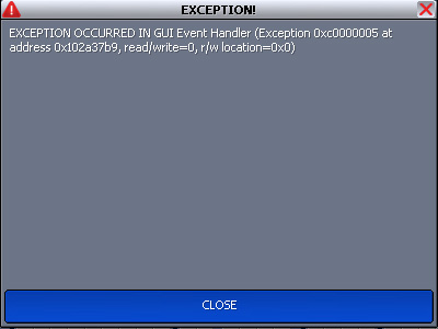

Winamp-DSP-Version: when I select Bojchas Sevdah FM-Preset from the dropdown-menue, I get this error-message, and the preset doesn't load in:
Edit: also on the Standalone-Version...
Confirmed, but with different address...
Also happens with multiple BS412 FM presets.
PostPosted: Sat Sep 06, 2014 12:21 am
Confirmed here as well. I'm currently *very* busy preparing for the IBC, but I'll try to fix it as soon as I can find some time...

- Crash when loading some presets fixed
