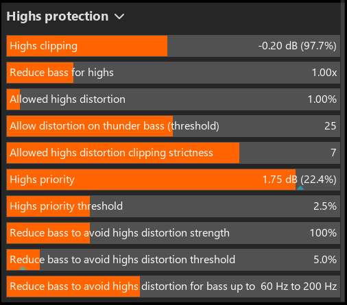

BETA024 is uploaded.
[*] Set "Reduce bass to avoid highs detection threshold" to 5%
@hvz detection? "Reduce bass to avoid highs distortion threshold" to 5%! This?
These in the screen are the other values of the new suggested settings?
