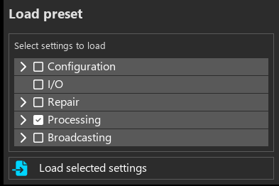

The check buttons on the loading preset page on stereo tool Mac vst3 don't work. the buttons dont engage when trying to select what I want to load from the preset.
same problem on standalone ST.

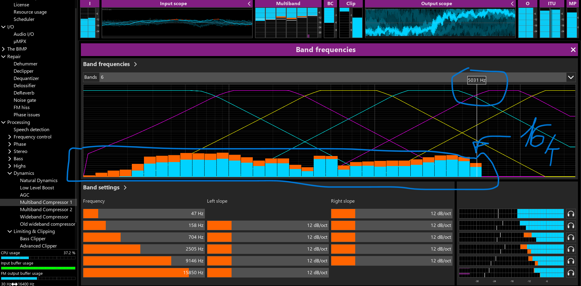

Edit: RF spectrum analyzer, maximum peak is not reset with right mouse button, as happened before
Edit: spectrum analyzer in multiband compressor (Good), but it is not aligned with the 20-20000 band of the "Band Frequencies" crossover, it must be adapted to that page or must be moved somewhere else, its own place on the home page it would seem more correct, why blue and red lines? what does blue mean and what does red?
No, it's not good, not only that it's not aligned, but also 'resolution'/'meter-band-width' is wrong, eslecially at low freq, so pretty unusable,
Play 1.19kHz sine tone and see how many bands will lit, or 30Hz tone.
Also meter release is bit fast, range is low.. etc
Again option to disable this, to save cpu.
Agree Bojcha since this CPU is a mess
I haven't tested it on an instrumental level, but I trust what Bojcha says.
