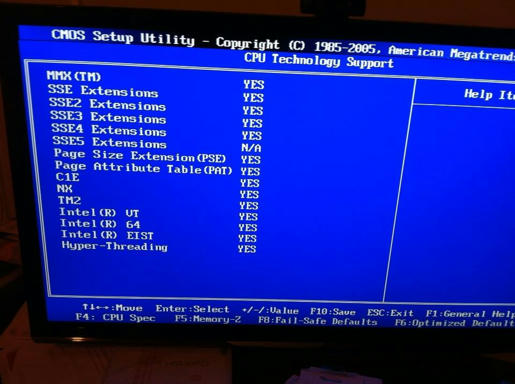

PostPosted: Mon May 23, 2016 10:00 pm
Posts: 164
Location: Antwerp
It is a MSI game motherboard BIG BANG X-power a i7-950 CPU at 3.07Gb, 12Gb Corsair XMP RAM
HD is a SSD Kingston via SATA3 6Gb/s
Here are some settings in BIOS...
I disabled overclock protection, no problem because CPU is cooled with watercooling.
