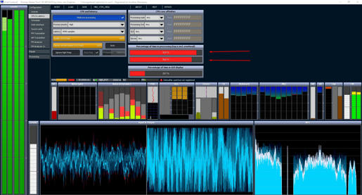

I told you before the CPU use with 7.85 on my computer.
i7 CPU, 12Gb RAM, a SSD for root drive
Installed b70 and when using almost all features in HD mode my CPU climbs to 50% use and works ok, much better sound as 7.84 which was not easy to control highs, this version is great.
When I Select FM settings (without Composite clipper) it goes up to 60% CPU.
With Composite clipper to 70% and I can't even use the features on that with (CPU) marked, it goes up to 90% and crackled sound when selected.
I added a screenshot of the overload in this post.
I can't believe my system would be to poor to run full options from ST, any ideas would be great to lower CPU use.
Thanks for all the work, that list becomes huger every time I read this thread :D

@GuntherM: I didn't expect the CPU load to be any higher than that of 7.84, will check
@Camclone: No extra license needed, I don't know what could be causing this. (Talking on chat now to resolve this).
PostPosted: Fri May 20, 2016 1:41 pm
Posts: 11424
@GuntherM: With the same settings (Delossifier disabled), I see 36% CPU load reported in Stereo Tool both in 7.84 and in 7.85-BETA071.
What was your old CPU load?
