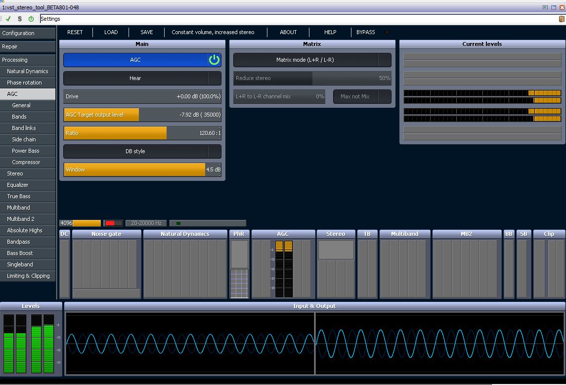

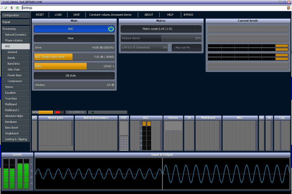

I have following issue with the new window setting in agc. With higher values about 4.5dB , left audio channel will be about 2dB less than the right channel.
I make a test with a 1kHz test tone and with the basic preset and switch off stereo boost.
I add to screenshots.
I use stereotool as vst-plugin in Wavelab
File comment: window value 0dB
File comment: with a window value of 4.5dB

I verified bacclux' problem for the dsp version. However it seems to happen for all Window values above 0dB and depends on the Ratio (obviously, I guess).
PostPosted: Tue Oct 11, 2016 2:44 am
Posts: 4248
'window' is not implemented well. There is 2 main problems.
- Window target is very slow
- Speeds inside window are 0 - should be something like 10x slower then agc speed(s) but not 0.

Bugs reported:
- Crash in DSP on first startup. 2nd start was ok.
- Crash when loading Jeroen's Sublime 80's preset (Fixed)
- AGC Window bands different (Fixed)
- Rename Start Ratio back to Ratio, we might not need this after all (?)
- GUI: the small processing time box is always showing 50% usage; on the CPU & latency page correct values are shown though ---> Should show the 1st CPU load from that page.
- GUI: in extreme mode for post-AGC & SB compressors the start ratio box starts on the right edge of the GUI but ends on the left, i.e. you see a part of the box above the peak meters
- SST auto-save settings in the background.
- Bojcha: 'window' is not implemented well. There is 2 main problems. - Window target is very slow. - Speeds inside window are 0 - should be something like 10x slower then agc speed(s) but not 0.
Bugs reported:
