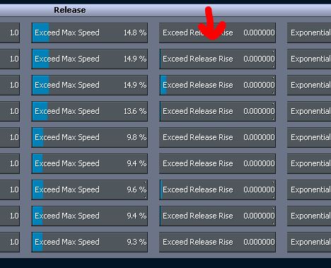

Just noticed I can't save Exceed Release Rise settings in MB2, Release part, dsp version beta 044.
File comment: beta 044 dsp

- Check Wunjo's Exceed Release issue - Tested in 048, ok
