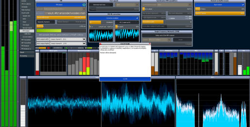

Unfortunately, it's still there.
PostPosted: Thu Sep 29, 2016 11:30 pm
Hm, interestingly I have rewritten the code exactly at the spot of this crash today! I hope it's fixed now, I'm going to run a new build now.

- ASIO latency back to what it was in 8.00, so settings from 8.00 should work again - Latency issue: Is it higher than before? And what to do with people who are updating? -> Just write in memory samples_per_step samples later
- ASIO crash (but I'm not sure if that was present in the previous beta or not) fixed. The code where GuntherM reported the crash is rewritten.

good news, it works fine now, case closed (I hope) :)
PostPosted: Fri Sep 30, 2016 11:19 am
Hans,
Pfew :) :)
If it wasn't fixed I would be really confused now.
