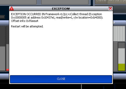

Just had a crash, when loading FM output with latest Beta
[edit]
Strange thing is, that if I load "FM output" first and than "Normal out" ST don't crash. So it's running now.
[edit2]
Just switched "Normal Output" first on and than "FM output" and ST crashed again (both ASIO)
PostPosted: Mon Sep 26, 2016 2:33 pm
I think I just had the same one here about 2 hours ago. Caused by ASIO, and also in LQLL Collect. I know the cause, need some time to fix it.. (few hours). However I can't reproduce it here (it happened once but not again) - if you can, please check the next beta and let me know if the problem is gone!
yup, I keep in touch :)

Fixed:
- Crash with ASIO fixed (reported by GuntherM) (I hope)
- Sound card not-always-exactly-the-same-latency-on-startup issue solved. This should allow using lower latency settings!
