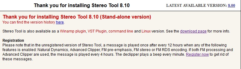

PostPosted: Fri Sep 09, 2016 11:10 am
Posts: 164
Location: Antwerp
Not a bug but probably a typo, when installed website says StereTool V8.10 instead V8.01 :)
