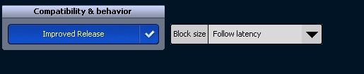

Hans, in beta 034 Compatibility & behavior in AGC is not visible
PostPosted: Tue Sep 06, 2016 2:05 pm
Turn "Show deprecated settings" on!
PostPosted: Tue Sep 06, 2016 2:15 pm
Posts: 128

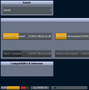

Ah ok its fine now! But it looks strange
PostPosted: Tue Sep 06, 2016 2:20 pm
Yup I saw that too. Not sure yet why.
Edit: Still not sure why, but fixed anyway.
