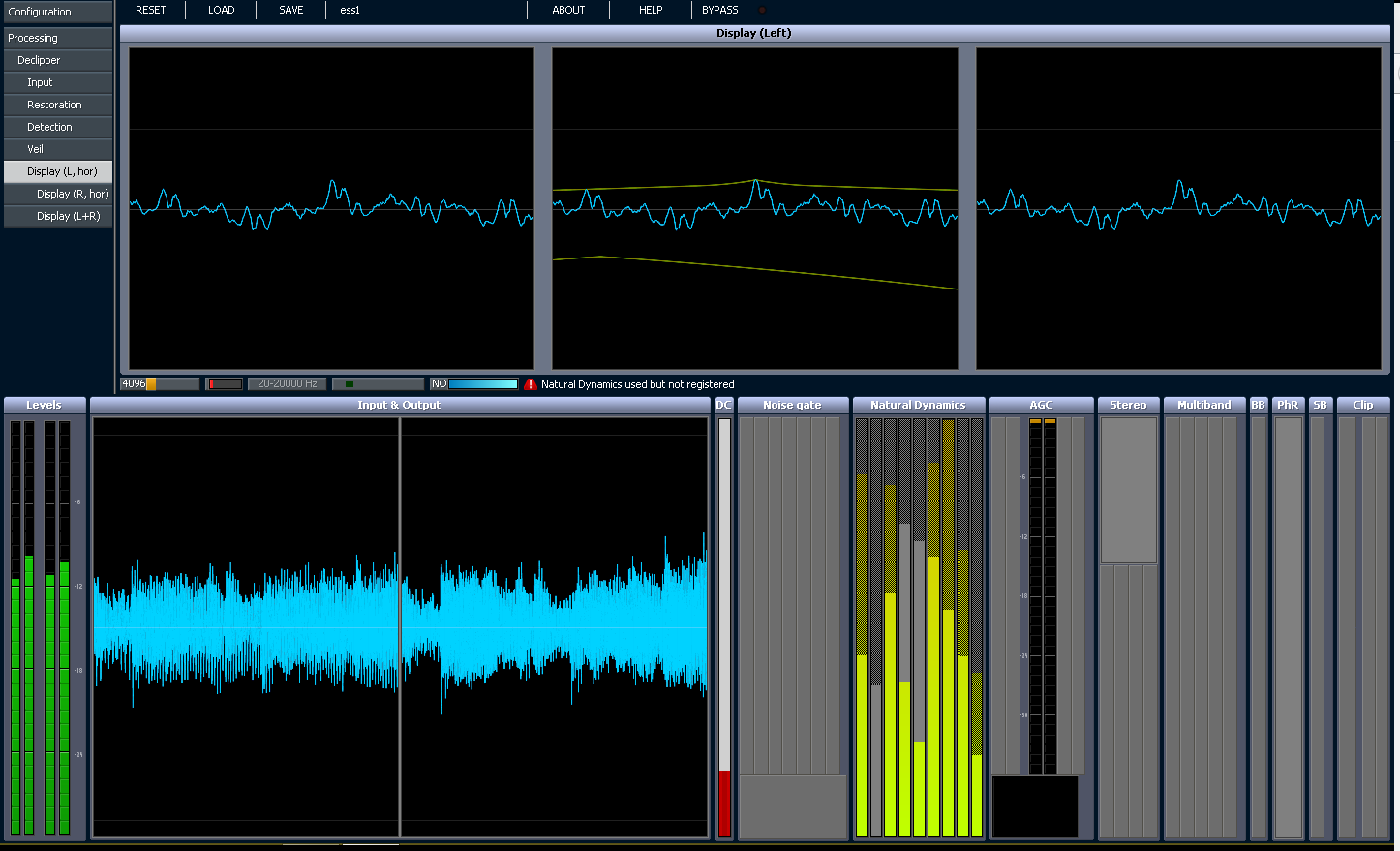

Hi to the group... I think i found a bug... when pnr is on decliper goes crazy....more photos in a bit..
