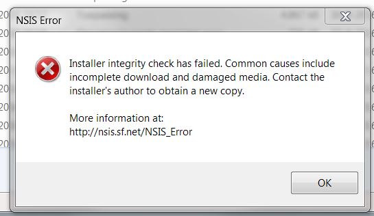

PostPosted: Fri Nov 25, 2016 3:10 pm
Posts: 96
Location: Groningen
NSIS error during install dsp 814beta001 ?
Tried to download twice, same error
PostPosted: Fri Nov 25, 2016 5:38 pm
Posts: 11424
Upload must have failed. The file is only 2.2 MB and it should be over 4. Re-uploading now.
