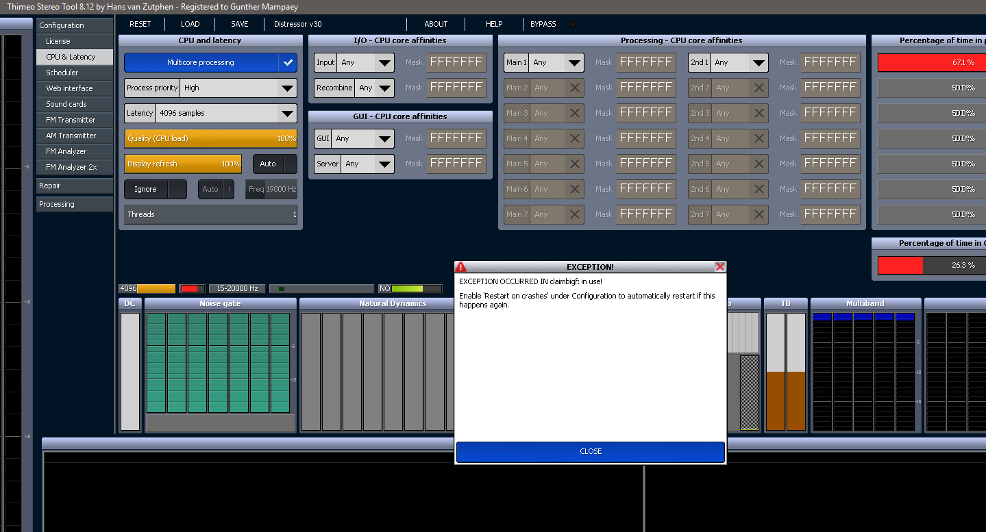

Uhm, just installed 64bit stand alone version of v8.12 and I get this :/
Does that reproduce when you start it again? If so, can you send me your settings?

I unchecked LQ output and ticked it back on, seems the problem is solved.
Strange, seems to run ok now.
[edit] it's LQ output that cause the exception
