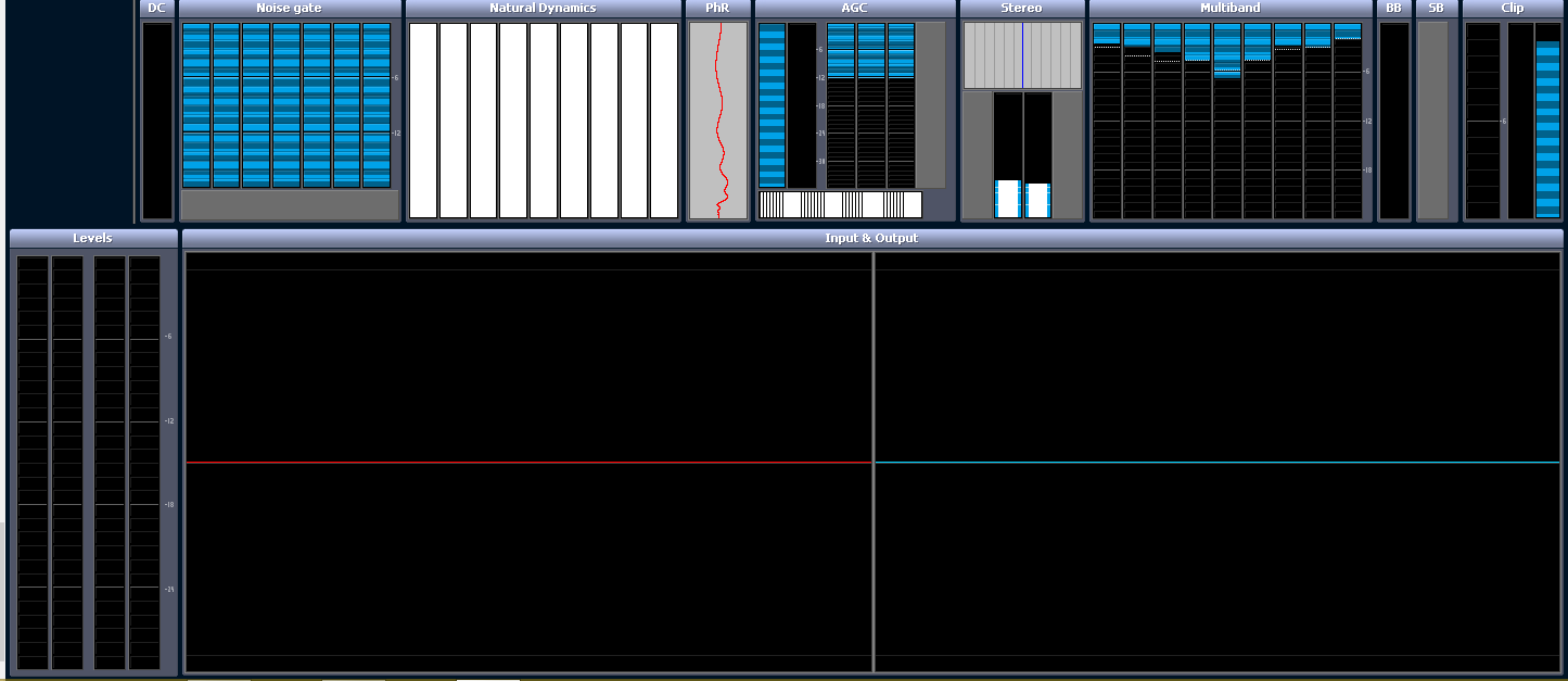

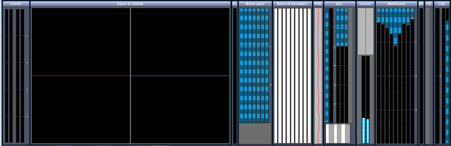

Hans i prefer the first placement being stretched than how the second one looks (current one is the second one)
My resolution is 1440x900 and my display is 19 inch Widescreen.
Ah, ok. That's just the default behavior at a specific screen size.
So is there a way to change that? One question from what i can see i understand that the gui has a "on the fly" resize algorithm. So why not making it possible to allow the user to resize the menus and meter on the fly. What i mean is to allow the user to move the meters (up and down) like the menu strip moves (left and right).
Thank you very much Hans for taking into account my ideas and "problems". That is Appreciated
(PS i only ask if it is possible to make the gui resizable . If it is a PITA then it doesn't matter of course)
