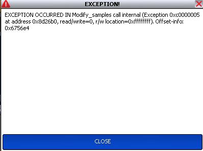

I`m reporting that i receive this exeption when i try to RESET ST ( factory reset)
Occurs every time when i load my preset and then make a "Factory reset" !
PostPosted: Sun Aug 02, 2015 1:24 pm
Ok reproduced it here! Thanks.
Edit: This is the exact same bug that Bojcha reported, but with address 0 instead of ffffffffffffffff. I didn't understand 0, but ffffffffffffffff makes perfect sense. Now I'm wondering if some CPU's might report 0 instead of ffffffffffffffff in case of an SSE unaligned read/write.
Btw, this still shouldn't happen, but at least now I know what to look for.

PostPosted: Sun Aug 02, 2015 1:57 pm
WOW, strange !
You know that i was told everyone that "AMD sees them all" , but now it looks that even that "Amd sees them right" (not wrong).
This is in case Bojcha has an Intel too :)

I've fixed the exception reported by DJ_DOGGY. I don't know if this also solves the audio problems that several people have reported now (probably not! But it's not impossible that it did.).
(Repeated) Note: Big memory usage reduction (78 MB!). Might cause problems (although I haven't seen any yet).
- Exception reported by DJ_DOGGY fixed.
