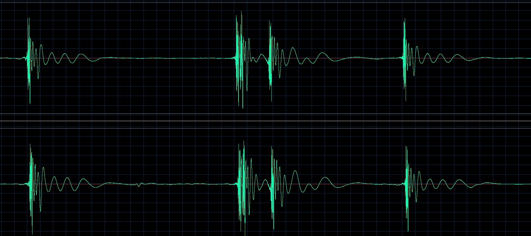

Slow fir top, optimized bottom. They look and sound very much alike (given the pretty loud hiss level and 50 Hz hum I wonder what's happening?? Some bad analog cable?).

Hans, I hope you can improve the optimized version of phase shaping further.. Un uptomized version is better but the cpu can barely handle it.
They should be identical - aren't they??? Then please send me your settings for testing!
1.. Phase shaping.sts
SLow fir --> richer and fuller
Ok, I've now also ran it through the stand alone version and there is really NO difference between the Slow FIR and optimized versions. And I have loaded the entire preset with IMPORT ALL. I'm giving up on this for now unless someone else can replicate this difference.
Note: To make the sound equal I've had to play the same piece of audio many times until all the meters (mainly AGC) settled, without that it DID sound different. When I play one version on the left channel and the other on the right I do hear some difference, but that's also there if I don't change the Phase Delay setting between Slow Fir and optimized.
Well the 50Hz could be there, and other little distortion because of HF.. Normally I don't record.
But when I look at the pictures of the waveform I actually see (small) differences.
But it could be that my mind is messing with what I hear versus what it.actually does (sees)
