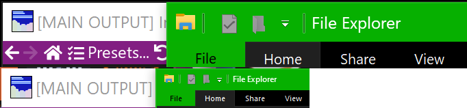

super minor: The titlebar in Windows does not scale to the DPI on a per-monitor basis along with the contents of the window. Not major but it takes up extra unnecessary real-estate.
monitors: Primary 4k @200% DPI, secondary 1080p at 100% DPI
As you can see in the attached screenshot, the 4k on the top looks correctly scaled to 200%. However the 1080p on the bottom is incorrectly scaled down to 100% like the file explorer. You can see the ST titlebar is 2x the size of Windows' precedent.
edit: This is the Standalone win10x64 version.
edit2: Valiant was able to confirm this. Let me know if I need to re-explain anything in better terms or clarify.

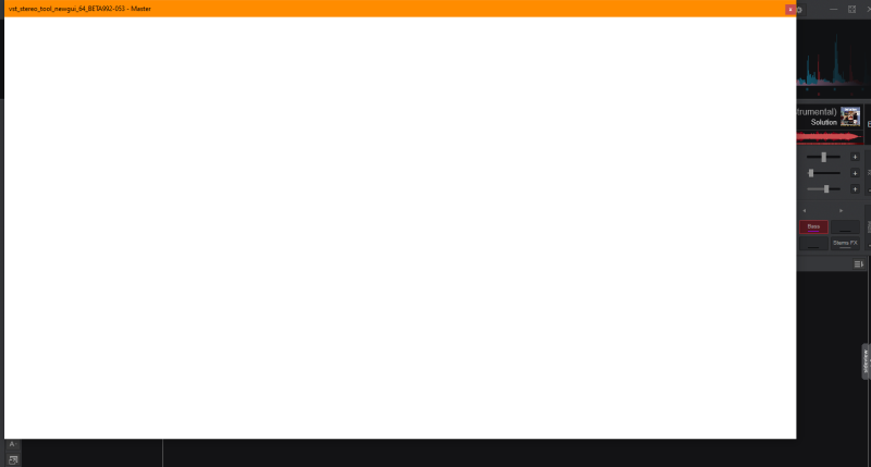

I ran into a problem with the newgui VST2 64 992-053 in Virtual DJ 8.5 b7131.
Only the first time opening the newgui works fine. The next time it opens with a white screen without content. I can move the mouse, at some places the arrow changes in pointer, but that's it.
After opening another VST followed by opening the newgui again gives me the normal gui, but again just for once.
This should be fixed in the new build.
