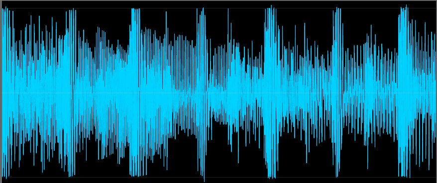

Not sure if this is a bug, but I noticed that in HD mode there are spikes on the output analyzer, in FM is it perfect between the lines.
PostPosted: Sun Aug 28, 2016 12:50 am
Posts: 11481
You're probably not using the oversampled clipper (you can turn that on in the 'Limiting & Clipping' panel). The scope *is* oversampled.
