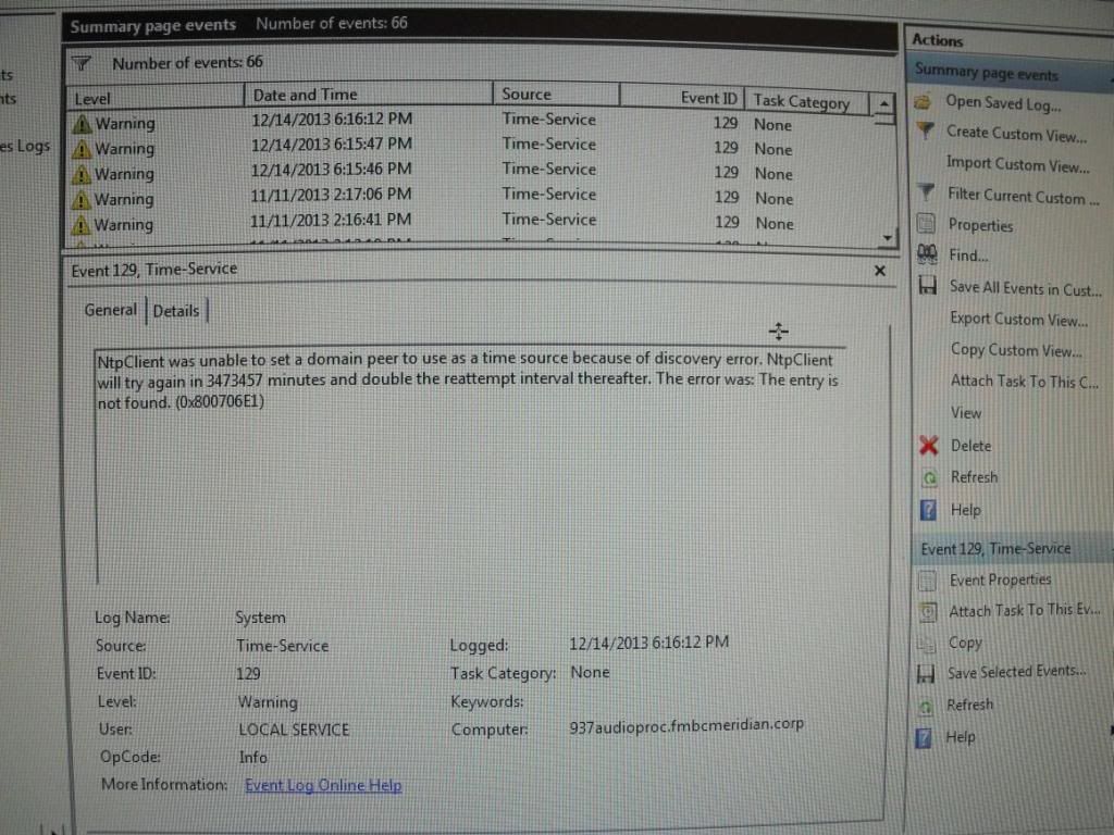

Not knowing what precisely to look for, here are a couple of screen shots. There is nothing listed for when ST failed, only for when I rebooted it. Let me know what you'd like to see.

I have never seen software cause an Event ID 129 error. If you are seeing Event ID 129 errors in your event logs, then you should start investigating the storage .May have a faulty SSD. Problem is definitely
NOT ST.

Thank you. That's the reason I posted those screen shots so that you guys could spot things I overlook.
