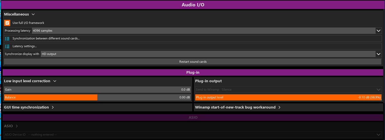

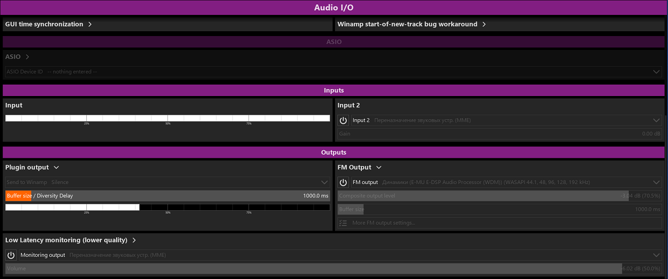

When I turn on "AM Signal Settings" and "AM Brilliance" I lose the "Web/HD/DAB clipper drive" setting in "Advanced Clipper" and the "Oversampled limiting and clipping" option
Strange! As in they're missing, or they grey out, or what?
They're visible and functioning here with AM Signal Settings and only AM Brilliance enabled.
edit: Ah I see your edit now. Strange indeed.
edit2: Can you show your I/O page?
edit3: my Lowpass Filter Signal before multiband compressors is greyed out however.
Yes, they are gray as inactive
below is the "Audio I/O"

Ah, so you're using a plugin and you've already tried enabling the full i/o framework. Hmm. Yep, I'm getting this in the VST2x64 too. I'm even able to enable "Lowpass Filter Signal before multiband compressors" like your image -- unlike in my standalone instances.
Pointing Hans this way.

I use VST2x32, I tried to turn on and off the full i/o framework, the behavior is exactly the same
