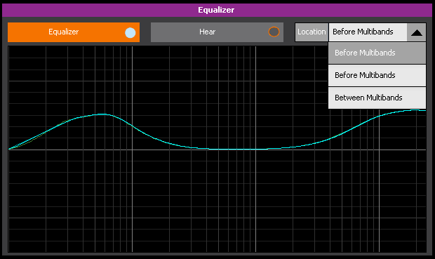

Hi Hans:
This problem in "Location" persist on v9.30 - 64bit - Standalone
Best regards
