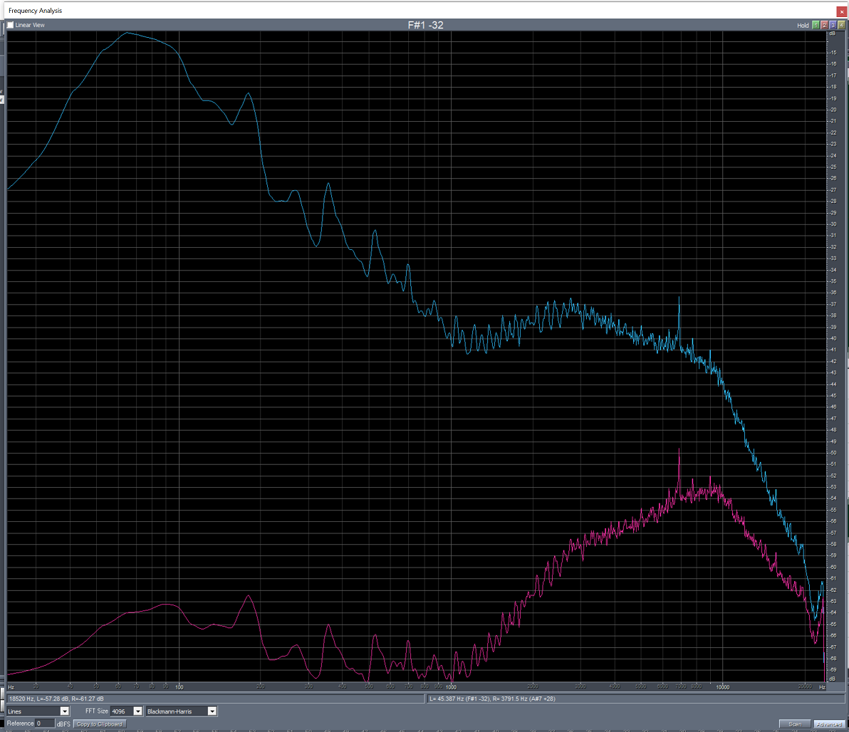

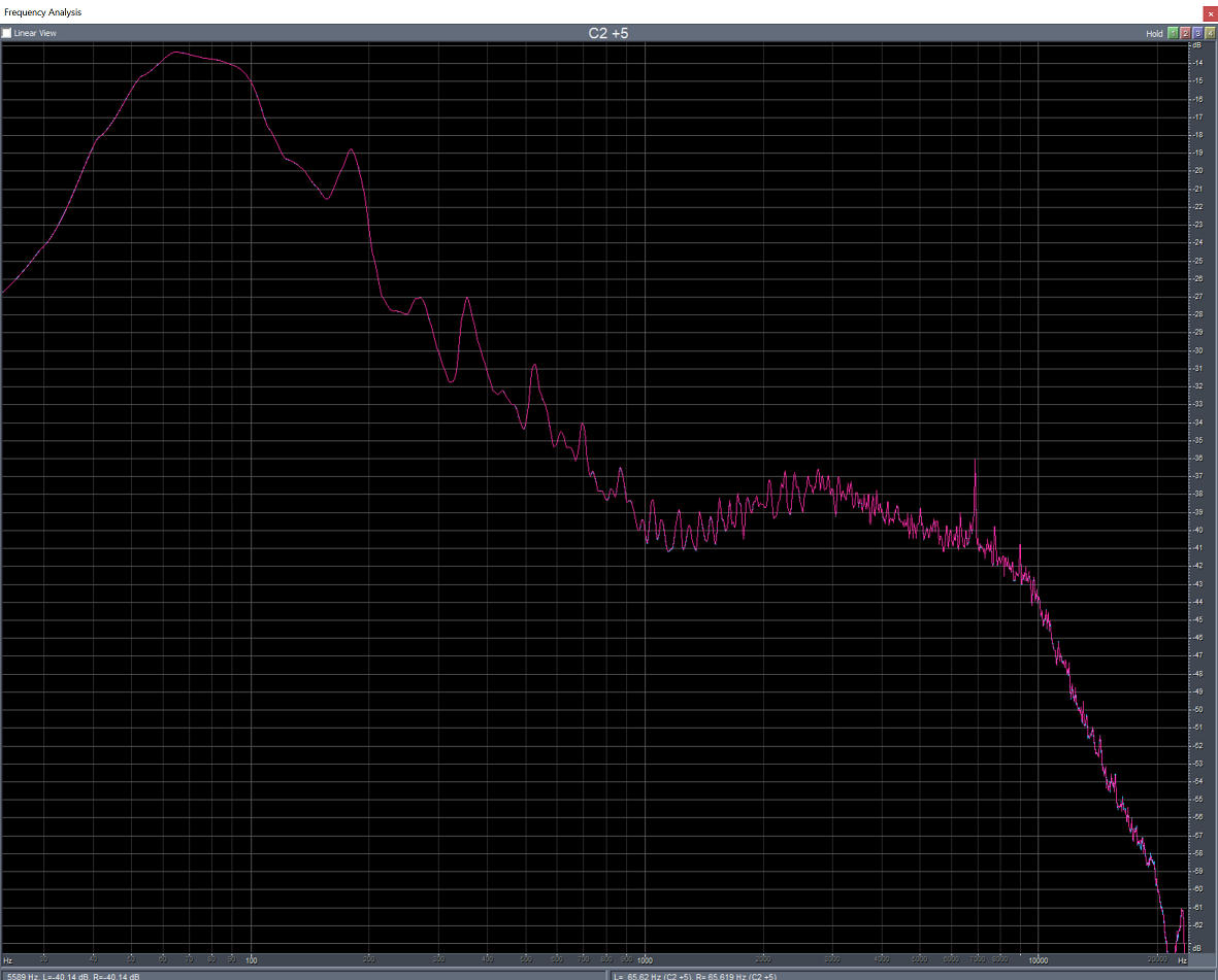

I couldn't post images in a PM (which is probably not a very weird protection...) so I'll reply here. (kastyak_ sent me some recordings, since I didn't see any difference on my end).
I think it's placebo... Here's why.
I compared your 2 recordings. Due to how Stereo Tool works, I can't do a perfect comparison because the music didn't start at exactly the same moment. But I have aligned the 2 outputs and then looked at the spectrum, and the difference between the two recordings.
First the spectrum. That looks like this. Cyan = 042, purple = 047.
Then the difference. Cyan is 042, purple is the difference between 042 and 047. Because samples are shifted, the processing and clipping won't do exactly the same, so I do expect to see a difference. But I see very little difference in bass and mids:
For bass, the difference is about 50 dB below the actual bass sound. For higher mids around 1000 Hz it's still 40 dB. If I listen to the difference, there's nothing that stands out - if certain bass sounds were being removed for example I would hear those. But all I hear is audio that sounds like the original audio, just noisier (which makes sense because it's clipped differently).
