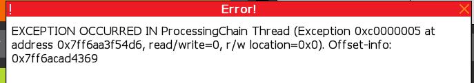

Hi Hans
Not sure if this the same error you are working on...
ST 64Bit SA
Thanks
Rossco
