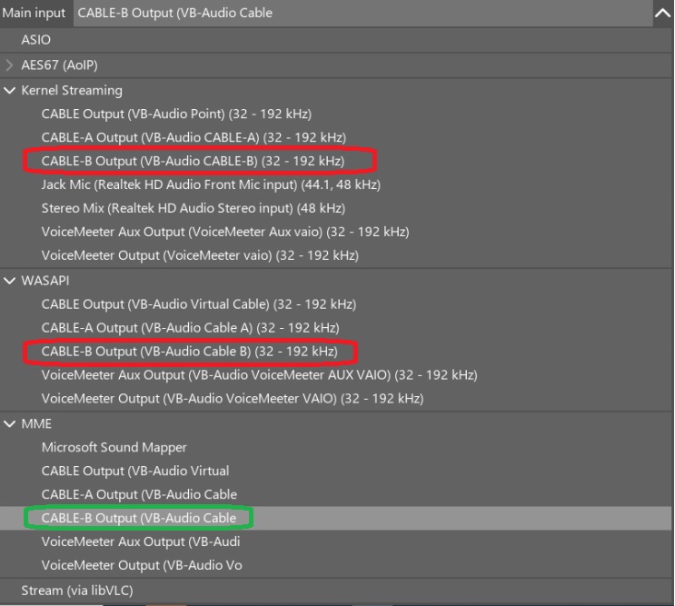

So, I tried to use the latest 10.02 Beta (and 10.0.1 earlier) and unfortunately the output of the sound was filled with crackling noises. My setup currently is this :
Jazzler --> VAC Input --> StereoTool --> Stream with the build-in engine or with RadioCaster.
At first I got scared and rolled back - most settings seemed to have been loaded properly which meant the preset was ok. Today, I tried again and I still got the crackling sound.
Finally I spotted that the culprit (in my case) was that for some reason ST had selected for my Input Kernel Streaming/ VAC - B Output . Theoretically Kernel/Wasapi/Mme should all be working correctly, but only MME seems to be working.
Red for Crackling, Green for sweet sweet sound!
Keeping The Rave Spirit Alive
https://raveunited.dance/
PostPosted: Tue Jan 17, 2023 2:21 pm
Hi dR_wH0,
So did the old version sound fine with Kernel Streaming? The selection should be the same. What changed is that we moved to a new I/O framework.
