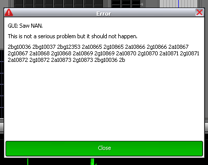

PostPosted: Sat Aug 21, 2021 2:53 am
Posts: 88
UPDATE: Duplicate bug - turning off the Dequantizer fixes this issue.
Windows 10
64-Bit
Winamp v5.666 Build 3516
ST 9.71 Beta039 (Winamp Plug-In)
Error
GUI: Saw NAN.
This is not a serious problem but it should not happen.
Screenshot attached. Error repeats immediately - no GUI updates in the processing meters and no sound. GUI updates in the INPUT meters.
Video: AMD Radeon R9 200 Series
CPU: Intel i7-5820K
RAM: 40GB
Drivers and updates for Windows and AMD are current.
