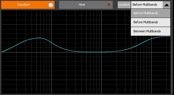

Problem in EQ
Appears 2 times "Before Multibands"
Best regards
