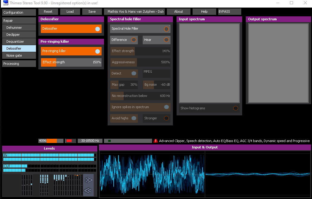

Ok quick update:
I think I have found where the problem is.
It seems if you have the 'Spectral Hole Filler' enabled, under the Delossifier' section.
This stops 'Bass Exciter' from working.
I found this on my test machine, while trying to find which setting was stopping
Bass Exciter from working.
Note:
I have the 'Difference' button enabled under the 'Bass Exciter' section, so that I can
see when the Output is showing a wave form.
As you can see from the 1st image below, with the 'Spectral Hole Filter' enabled
the Output is just a flat line, showing that the Bass Exciter is not working.
The 2nd Image with the 'Spectral Hole Filter' disabled, the Output now shows a
wave form, meaning that the Bass Exciter is working.
Is this correct, or should the Bass Exciter be working with the Spectral Hole Filter
enabled, and this is just a bug I have found?
File comment: Spectral Hole Filter - Enabled
File comment: Spectral Hole Filter - Disabled

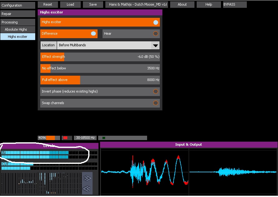

I wonder if you can advise me on the following:
I see that you have added, 'Highs Exciter' and 'Bass Exciter' in this new release.
I have enabled both of these new settings, but when I press the 'Difference' button, on the
'Bass Exciter' it only shows a 'flat line' on the 'Output' waveform graph.
When I do the same for the 'Highs Exciter' the waveform then shows the
difference i.e. it is oscillating up and down.
Therefore, is there another setting that you know of, which may be effecting
the 'Bass Exciter' from working which I may have inadvertently turned on?
Please see below for screenshots.
Thanks in advance
Mark
hello, all is well for the evaluation that I made on your post, there is an input gain, this one will also cause some noises in your AUDIO as it passes through the processor and declipping tries to make the correction...
