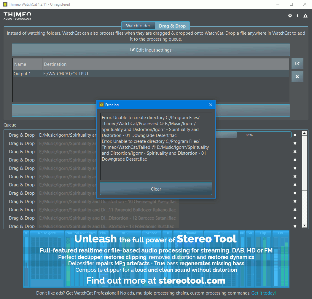

Drag and drop seems to no longer work? I tried in administrator mode, as well. The source files are FLACs. And the containing Folder doesn't want to drop either. (Win 10 x64)
The last version or two would throw up an error and claim it was unable to create the output file, but it still worked anyway.
Will WatchCat be given a little bit more work once the new ST GUI is finalized?
Thanks!
edit: It also doesn't want to look in subfolders placed in the input directory.
edit: Ok, it accepted a drag and drop while it was processing stuff inside the watch folder.
edit: This time it accepted files via drag and drop, but it threw up this error. As you can see it thinks it's placing files in Program Files\WatchCat, even in administrator mode, but they're actually properly created in the assigned output folder.
PostPosted: Sat Apr 04, 2020 11:43 am
I just tested the latest version and it works fine here - without any error message. But it won't work in admin mode, because you're drop action does not had admin rights.
Edit: O, I hadn't updated so I hadn't seen your screenshot yet. That is very weird. Doing some tests here...
Edit #2: No, it definitely doesn't do that here, and if I run it outside of the Program Files directory it also doesn't create those directories. (If it would try to do that, it makes sense that it would fail). More investigation needed...
Edit #3: Ah, found it. In the input settings there's a radiobutton, where you can choose what to do with the input file after processing. Default setting is "Do nothing", which works fine. If you select "Move input file to "Processed"", you get this error message. So I guess there's an error in the handling of the directory of dropped files.
